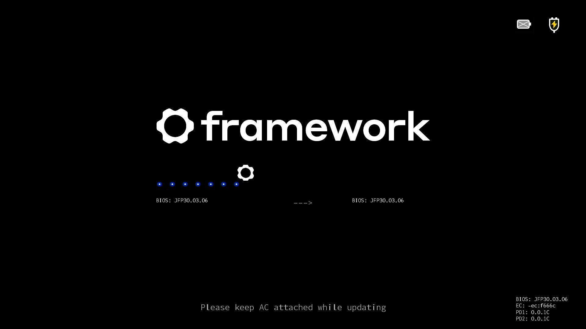

  5. After rebooting into the updater, the update will commence. The updater will update the BIOS and EC.A screenshot of the BIOS update screen.

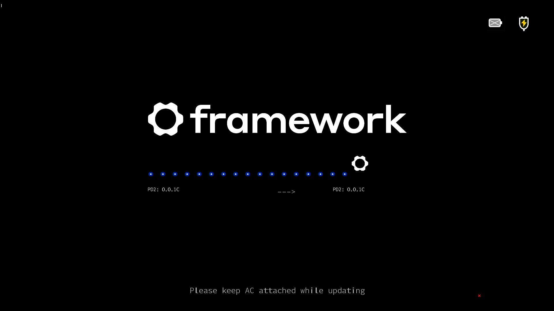

  6. The Updater will update the PD controller that is not connected to the power source.A screenshot of the PD controller updater.

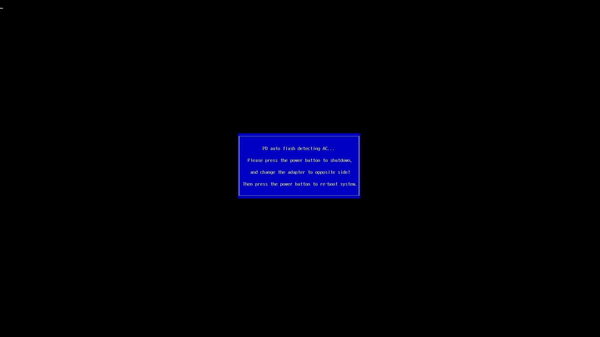

  7. You will see one PD controller will fail the update with the X, and "Update Complete" is displayed, but the BIOS will restart. At this screen, the BIOS update will stop. You must disconnect the display and power source, and move them to the other side. * Connect the display to the top right port. * Connect power to the bottom right port.A screenshot of the PD controller updater with the message for next steps.

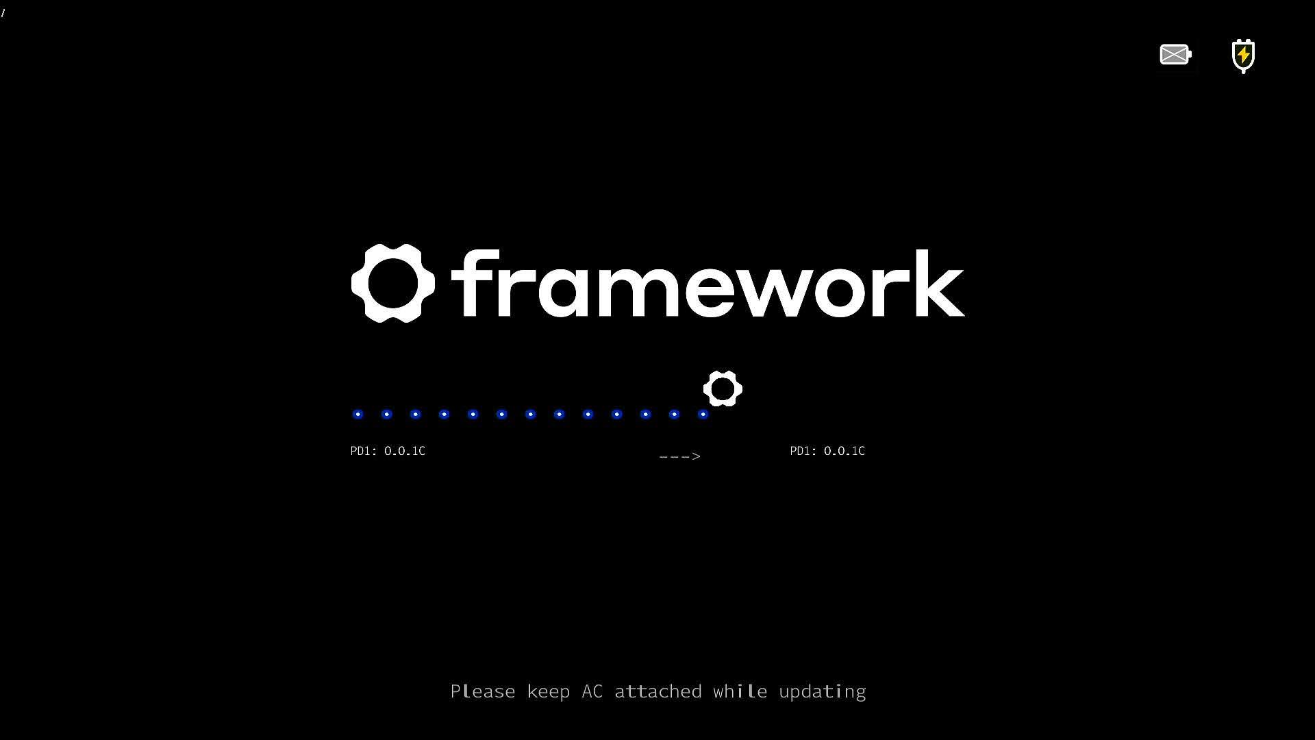

  8. Press the power button, and the second PD update will complete.A screenshot of the PD controller updater finishign the update.
