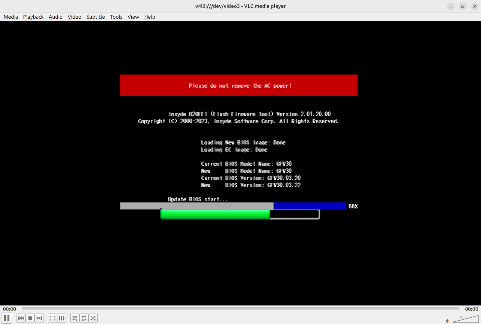

  1. Download the Framework Laptop 13 11th Gen Intel® Core™ BIOS 3.17 Windows Installer.
  2. Run the .exe and click "Yes" when prompted to reboot.
  3. Wait for the firmware progress bar to complete — the system will reboot automatically. Do not interrupt.

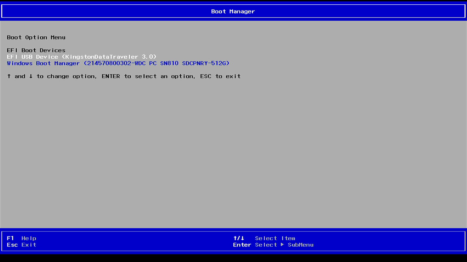

  5. Select the EFI USB Boot Device.The Boot Manager menu with the EFI USB Device selected.

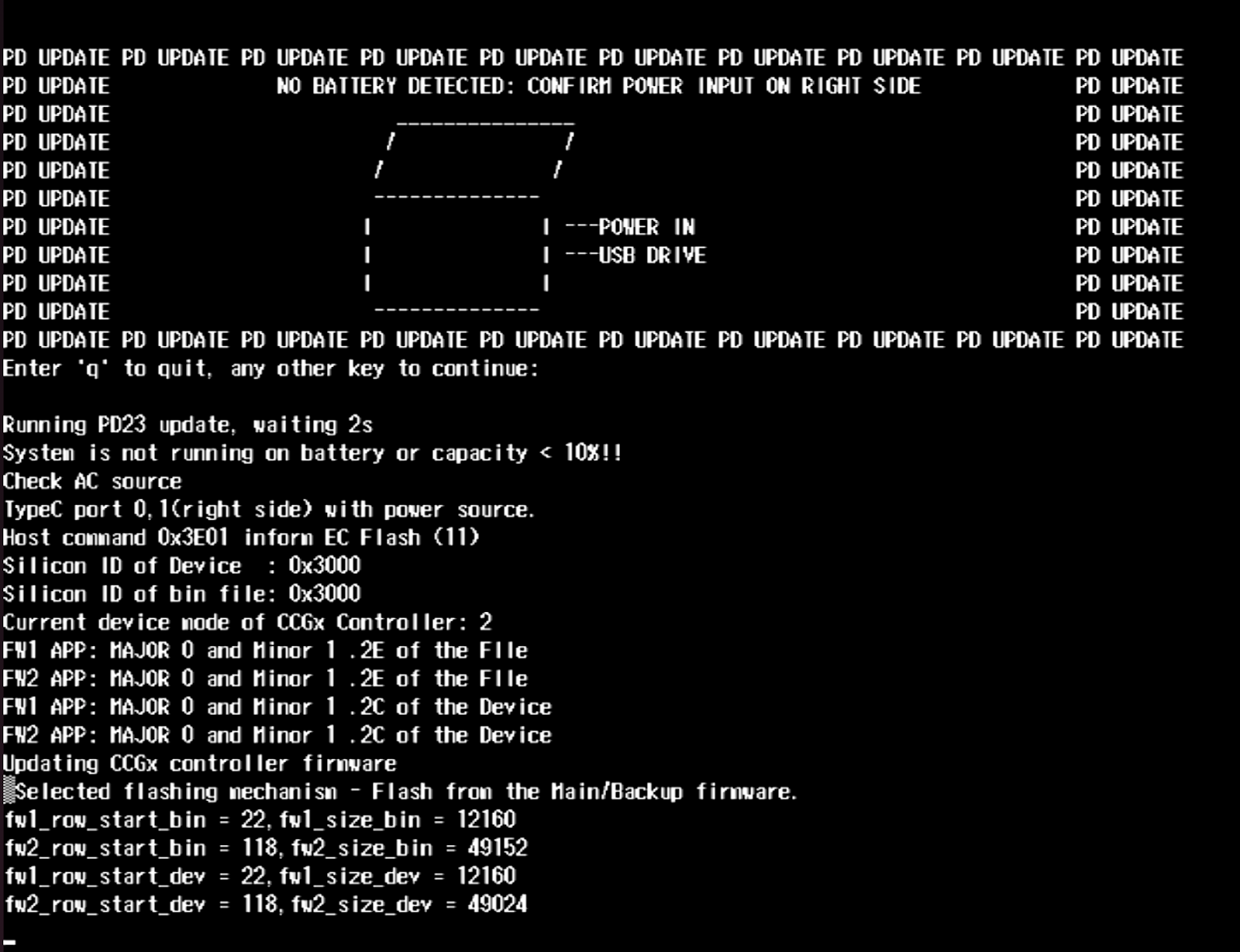

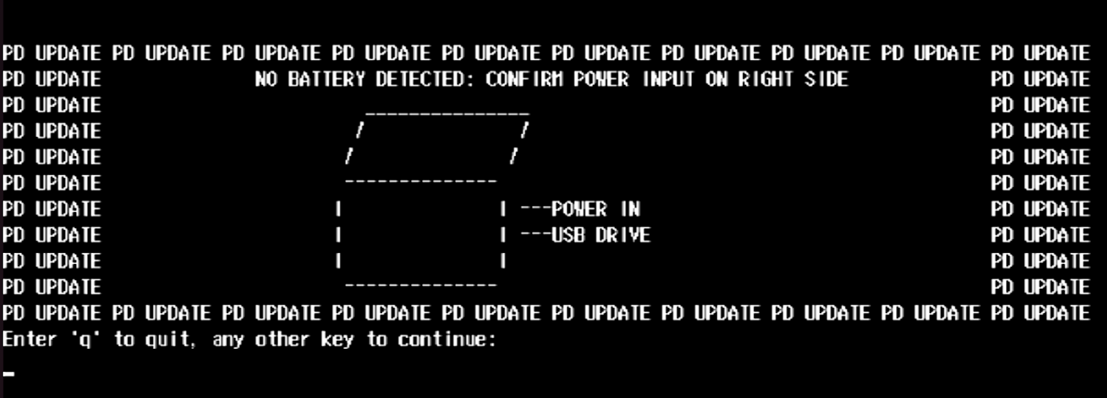

  6. The updater will update the PD controller on the right side. Press any key to continue updating.The PD updater asking you to confirm that power is connected to the left side.The PD updater flashing the right side PD controller firmware.

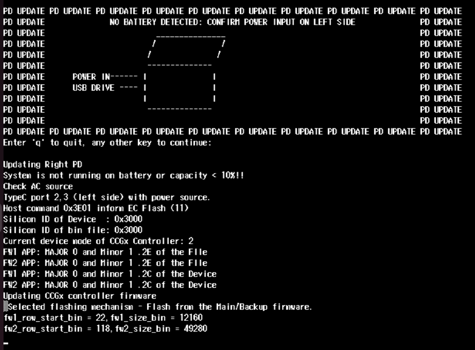

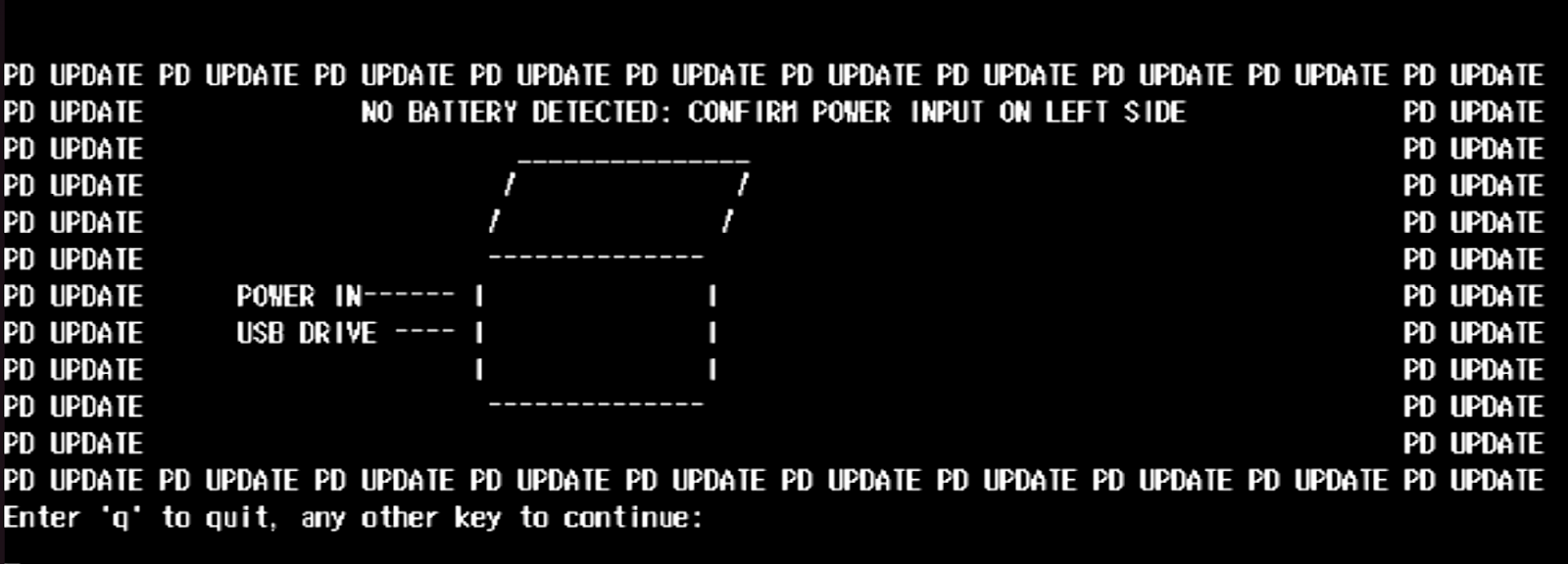

  7. Move the display to the upper right port and the power to the lower right port, then boot back into the EFI updater. The updater will update the PD controller on the left side. Press any key to continue updating.The PD updater asking you to confirm that power is connected to the right side.The PD updater flashing the left side PD controller firmware.

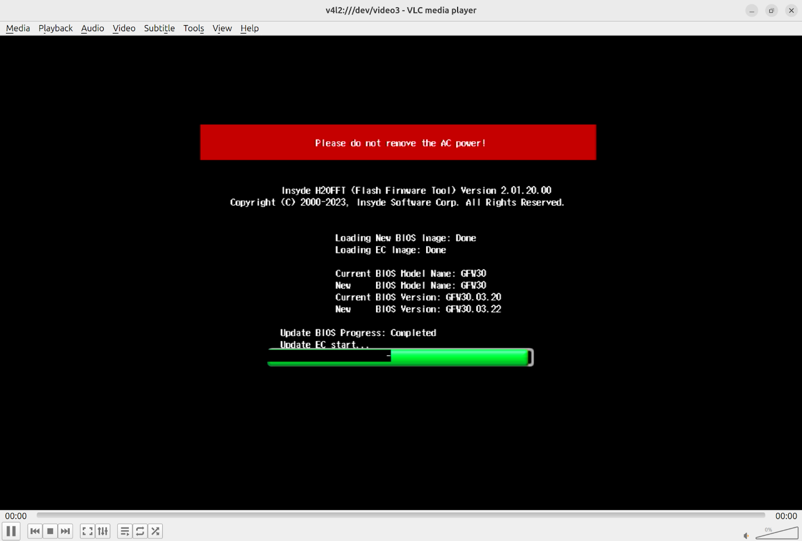

  8. After the PD updates finish, the system reboots automatically and starts the BIOS capsule update.The BIOS capsule update in progress.
  9. The EC updates once the BIOS section finishes.The EC update in progress.
